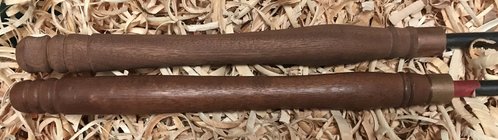

two Jamieson gouges wth sapele handles. Sapele is free cut offs one of our club members brings to meetings

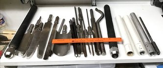

Photo illustrates the offset drilled dowel. (about 1/32" from center)20210531_120032[1].jpg
The original maple and pvc handle.
