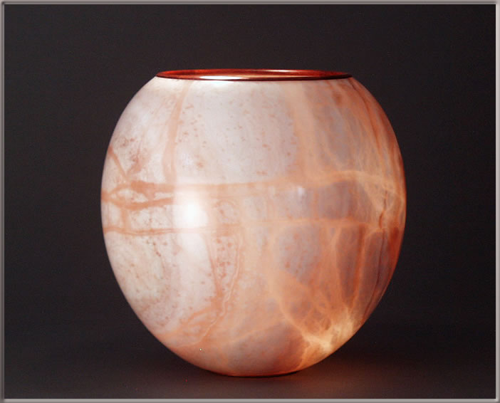

For something totally different, consider alabaster. coloradoalabaster.com
(I have no financial interest and have not yet tried it myself) Photo by Max Krimmel.
