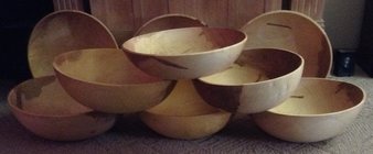

I've turned a lot of 18" bowls, 24 to be exact. Happy that this patron paid for my Oneway 2436. I sharpen about every 3rd pass as I get near the end. And by sharpening, I mean one pass on a 120 grit CBN wheel. I also use the Hannes grind which gives me a much better shearing cut. Then I move the gouge much slower on the last pass or two. Finally I find that a light grip on the handle makes a huge difference. Let the gouge do the work! Another tip is that shown hardly anywhere for the inside of a bowl. It's a super fine shear scrape with the bowl gouge. Flute is turned over and the bottom of the handle dropped as low as I can go. This lets you feather off any little blemish.
