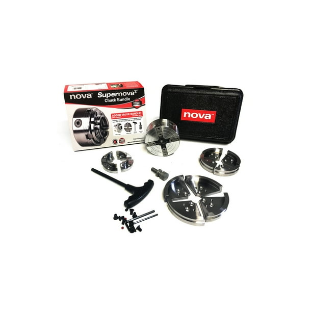

I'm looking at a Nova TK-23099 Direct Thread 1 1/4 Inch Supernova2 Chuck Bundle Gifting Set or something similar for a PM2014 I've just bought. The PowerMatic is reversible and I can't find any info about whether this chuck is reversible aside from one comment saying there is a set screw/grub screw on it. Nothing in the specs though. I am also unsure if these jaws are dovetailed jaws or if that is a standard for the Nova chucks. (Newbie here) Does anyone know those answers for this chuck?
I intend on doing bowls and hollow forms primarily. The PM has 1¼ x 8 TPI spindle threads so any alternative suggestions would need these features....
  • 1¼ x 8 TPI
  • dovetail jaws
  • reverse capacity
  • expandible system with more available components
This bundle seems to have a wide variety of jaws to start with so I'm looking for bundled sets for now.
The PM2014 won't ship until the end of April but I'd like to have some of the basic accessories available when it arrives.
I am upgrading from a Rikon 70/100 with a 1 x 8 TPI spindle so I've ordered an adaptor for my current chuck and faceplates but won't be able to reverse turn with them.
Here is a pic of the set I am considering.
Thanks!
Al in Texas
You mentioned that the chuck has a set screw, so yes it can be run in reverse. The set screw is tightened on the spindle and will resist the tendency of the chuck to unscrew from the spindle when the lathe is running in reverse, but just understand there are limits (and these apply to all brands of chuck).
The two larger sets of jaws are, I believe, the 100 and 130 mm and these are dovetail on inside and outside of the jaws. The smaller set is probably the 50 mm. These are dovetail on the outside (expansion). On the inside the contour is hard to describe, I have heard it called a bird beak.
The Nova jaws are a standard dovetail on the outside for gripping in a recess. The inside of the jaws on the standard bowl jaws is described as a dovetail, but it's not quite. It's more of a minimal slant with a small rim on the inside of the jaw to aid gripping. There are a whole host of jaw sets and it seems to me that the powerjaws are a true dovetail on the inside, but I can't be sure without pulling one out. Others may be as well.
I bought that same bundle a couple of years ago; my Amazon purchase history says I paid $160, so the price has gone up, but it's still a fairly cheap vs buying the chuck and jaws separately.
Since it's direct threaded, there is no place to put a wrench to remove it from the lathe. You can use an oil filter strap, or put a board between the jaws, or get a spanner type tool to hook into the allen wrench slot you use for tightening the jaws.
I've found homedepot.com to have good prices on Nova jaws. You might look there if you want to add more jaws.
Yes, Tools Plus and for some reason Home Depot have been the two sources where I've consistently seen the best prices on Nova accessories. I like to use the HD if I can because I don't pay shipping and I can choose to pick it up from a store in a nearby burb with lower sales tax. And if you do in store pick up porch pirates are not an issue.
