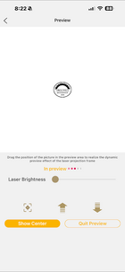

yeah I think it's a very tiny very faint center dot that is hard to see - I never thought to try before but maybe try holding a plain white piece of paper over the area to see if the center dot actually is being projected - But I always just relied on the box myself because most of my badges also fit very nicely within a box formed so the points touch the ring in a 2" -ish recessed foot, or otherwise a ring made with point tool that I usually make to decorate the bottoms... so that pretty much gets it centered for me..
On the LP1 using their software [on an iphone]. When I hit the preview button it shows the box shape. On the lower right of the screen there is a button that says "show center". I will try to get a screen shot when I head down to the shop. One thing that sucks with this software is it needs to hook to the laser or it won't let you do anything.
It's hit and miss getting the centering dot to show. Just have to keep backing out and go forward till stuff starts working.

As far as the center point goes, after I've set the design and size, I have the choice of a preview button or next (or burn?) button. No clue why you'd want to just start without aiming... When I hit preview, I get the flashing square showing size and location of the burn area. There's a slider for intensity that makes it lighter or darker. Sometimes I have to turn it up to see, and that's for a large flashing box. The center point is tiny, so you almost always have to turn up the brightness to be able to see it. It can be handy for centering stuff. For some unknown reason, mine hasn't been just showing the center point, but it becomes the corner of a shifted flashing box.
