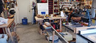

Looks like you have a well equiped shop! And is that a cat door? Since slowing down a bit I haven't used any of the flat-wood tools for years, except for the drum sander. I'd be happy with just a couple of lathes, bandsw, grinders, drill press, and electric chain saw. (Of course I'd have to keep the little welding shop, the mini machine shop, and the shop computer and piano. Good clean fun!)

Yes it is a cat door, with 7 cats on the other side. I plan on joining my local chapter after I retire. And the bandsaw now works properly. Thank you for the replies
