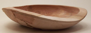

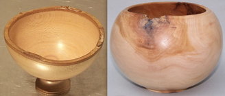

The center of this form was a nice round ball when turned.0EB7715A-9878-4E4D-A7A7-138C5BC13D82.png
These screen shots of the dry sycamore bowl I turn in a demo show how oval it got.79EDCFCE-6874-495B-9DC3-611FA6F33894.jpeg
Made a nice demo and when the hollowing begins there is a huge difference in wall thickness 01316A63-AC69-45D8-AB4B-FADF40464950.jpeg
