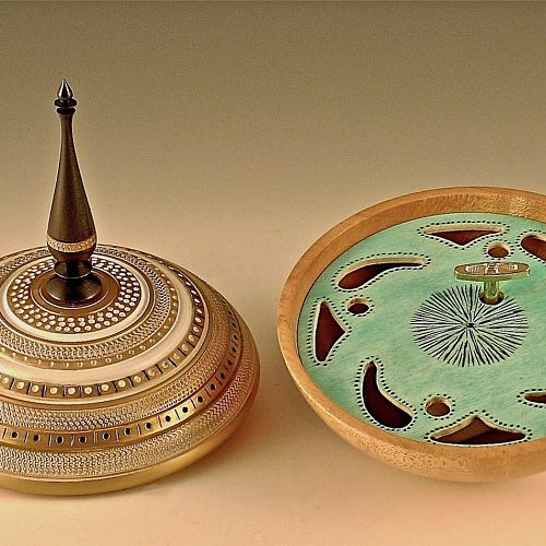

I have done demo's on making them out of a solid piece of wood without using a separate piece for the bottom. I make a loose fitting lid with a chamfered edge that matches the top of the box to center it and insert a glass coaster in the top to protect the movement.
