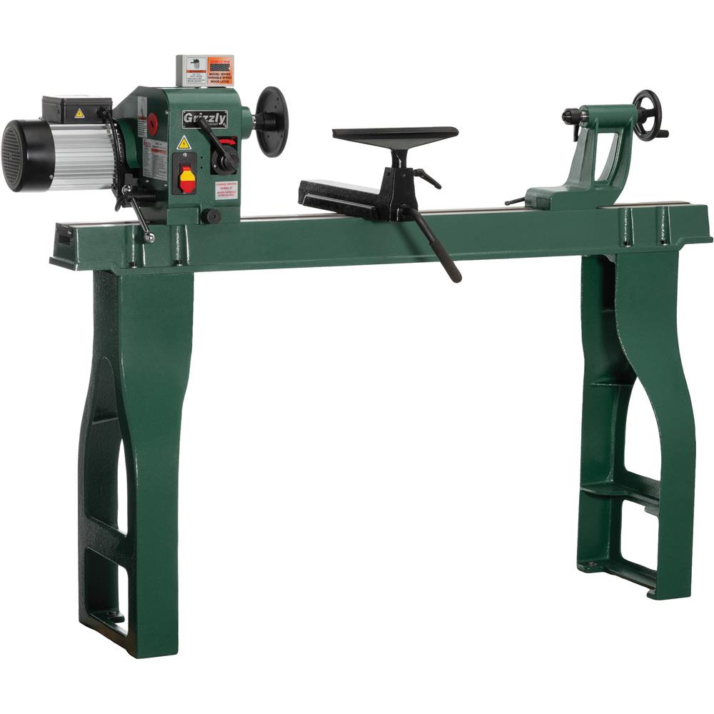

Hello,
I'm new to woodturning and I recently bought a used Grizzly GO462, shown in the attached photo. The previous owner put a 3-jaw chuck on it and I've read that these chucks are intended for metal working, not wood. Is this true? Is it safe to use for woodworking? It appears that the chuck jaws are adjusted and tightened by rotating the two halves using two round keys in the provided holes. Any tips or instructions on using the chuck would be appreciated. I think two phillips screwdrivers will work, but I'm curious to know what the intended chuck keys look like so I can make one or buy one. Lastly, I need to get my bench grinder set up to sharpen my tools. The lathe was sold with a set of Steelex tools. Is this a good brand? What kind of wheel should I buy for sharpening them? CBN?

That chuck is for metal turning, not wood, and it can be dangerous. Get rid of it and buy a decent 4-jaw chuck (Vicmarc, Oneway, Nova).
Steelex tools can get you started, but if it is a boxed set chances are pretty good you'll never use some of them (don't ask me how I know!).
CBN wheels are the way to go for sharpening.
Thanks for the information! How is the chuck removed? And what should I look for in a new chuck to be sure it's compatible with my lathe?
The chuck is screwed on to the lathe's spindle. If the chuck has been on there a long time you may need some wrenches to loosen it. You'll need to hold the spindle while freeing the chuck. If it doesn't want to unscrew, some penetrating oil might be worth a try
Thank you. So I'll just measure the spindle diameter and look for a new chuck that matches? Are the threads typically an industry standard?
Locate the model number of the lathe, then go the Grizzly.com and look it up. Grizzly usually has the manuals for their machines available for download. The spindle on that lathe is either 1"x8tpi or 1-1/4"x8tpi.
Per the current grizzly web site
its a 1-8 thread. Still check the diameter first.

Be aware that some chucks, notably Nova, require an insert. The insert is sized for, and threads onto, your spindle. The chuck then threads onto the insert. There are some chucks that are direct thread and sized for a specific spindle. If your spindle is indeed 1", rather than the more common 1 1/4", then I suggest you go the insert route. That way if you ever choose to buy another lathe you can replace the insert and keep the chuck. And if you decide turning is not for you, then the chuck might be easier to sell.

The main concern with this 3-jaw chuck for woodturning is the potential knuckle buster if you get your hand too close to the jaws
while the lathe is turning. There are better choices of chucks to hold a wood billet or spindle piece but this one will work in a pinch.
I have several 3-jaw chucks that I use on several different lathes for certain projects where the jaws work for the task at hand. The
chuck you have usually use a set of "Tommy" bars basically two steel rods that are leveraged in opposite directions to open or close the
jaws on the chuck, you can easily make a set of steel rods and add handles or find a couple of screw drivers with the proper diameter
shafts to fit the holes in the chuck. Like any other accessory used on rotating equipment you need to know the hazards and your own
limitations working around these accessories and take safety precautions when using them.
Mike makes a good point concerning “knucklebusting”. All chuck jaws provide the same “opportunity”. Use a grinder, file, whatever tool and radius the OD corners at the top of jaws and the jaw base plate. Not as much damage to skin and bones or tools if they contact these areas.
David, I don't believe anyone has mentioned that those jaws are reversible....probably recommended for woodturning. I have a Grizzly 3-jaw (6") that I bought in1985 and used it for about six years before I got the original Nova 4-jaw chuck (with tommy bars). Don't recall having lost any (or too many) pieces. Mine looks to be much heavier than yours and has a square drive chuck key. Did a search on Grizzly...no luck.
