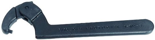

The tool I find most effective for loosening chucks is an adjustable pin spanner. There is a hole near the back of Nova chucks- access to a set screw. I hook the tool in, with spindle locked, and give it a slap. It’s effective and doesn’t stress the chuck, lathe or me. You could also hook the chuck tightening Allen bolt, or even a jaw. Really good tool to own.1640989545902.jpeg

The tool I find most effective for loosening chucks is an adjustable pin spanner. There is a hole near the back of Nova chucks- access to a set screw. I hook the tool in, with spindle locked, and give it a slap. It’s effective and doesn’t stress the chuck, lathe or me. You could also hook the chuck tightening Allen bolt, or even a jaw. Really good tool to own.View attachment 42087
Where would one find such a tool, Marc?
Any industrial supplier will probably have them. I bought a "fixed pin" spanner for my Record chuck about 6 yrs. ago. They are considerably cheaper than the adjustable pin spanner. Current price is about $6 more than I paid. My wrench was for a 2" diameter.
