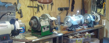

My sharpening station at one time, changed some now. Wolverine bases and grinder mounted on 3/4" ply so they can be moved or transported to a demo. I devised a way to use Tormek jigs on a bench grinder long before Tormek decided to offer a stand to hold their jig support rod. I like to think they got the idea from me since I wrote to them, set a picture, and told them how useful it was and suggested they make one for sale. It's perfect for SOME things. (With severe ADHD I like lots of options.)
Note, I shaped the wood stand to clear the wolverine base locking handle. I had to reverse the wolverine base handle for clearance - just take it apart and reassemble it in a different way. Simple.

Seems like you said you will have a grinding station. Why not build a flip cabinet that uses no more space and has the same footprint. And since you are in a small shop, might be useful for another pare of tools.
Oh, that solves a problem for me....going to do that with a spindle sander and a disk sander.
