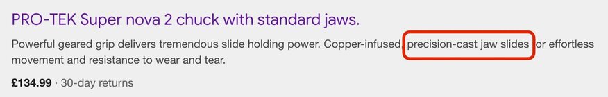

As I mentioned earlier though, Nova say their Jaw slides are Cast.
Sintering is quite different from Casting.
No, they’re definitely cast:
Just curious. Did that information come directly from Teknatool or somewhere else? Is it from an advertisement?
The reason I ask is I tried searching for info on jaw slides directly from Teknatool and all I could find on the internet was this, kind of sparse and lacking technical details. (maybe they are being vague to protect manufacturing process technology, or maybe they can imagine anyone caring)
Copper composite Jaw Slides
and further down the page:
High Tech Precision Composite Jaw Slides.
But I'm certainly no search guru. And the last time I checked I was still not a Teknatool engineer or a materials scientist with an analytical lab. Maybe someone else can find more official info.
Looks like he'd be right - From Nova's own product catalog (Circa 2018, though) " HIGH-TECH JAW SLIDES The copper impregnated cast iron slides have an extra long life and are self lubricating for easy movement and resistance to wear"
I always figured them for pressed metal, myself (I worked with a lot of components in pressed metal, vs cast iron, and judging by the fineness of the Nova slides, I'd always assumed they'd have to be Powdered metal, so if it is actual cast iron, they've done a superb job of it!)
From their website: “The copper impregnated cast iron slides”
