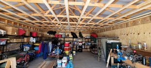

Congratulations! That will be a nice upgrade. Well insulated? Heat and ac?
Thanks. Not yet. The walls are insulated with plywood over. I am cleaning it out and will insulate the ceiling and plywood. I have a 55,000 BTU pellet stove from my last house I was going to install. Not sure about A/C yet

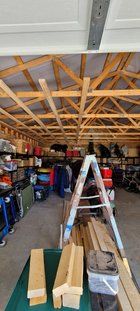

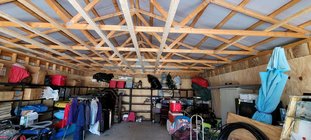

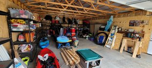

Went through the shelves and got a couple of truck loads ready to go to the dumps. I am going to build a room at the far end for storage. It will be 24 feet wide by 6 feet deep. I will be able to put 10 of those shelves in there and a clothes rack for my wife to change out her seasonal clothes. That will leave me three shelf units to store wood and drying bowls. I will also build a small room to hold my air compressor and dust collector.
