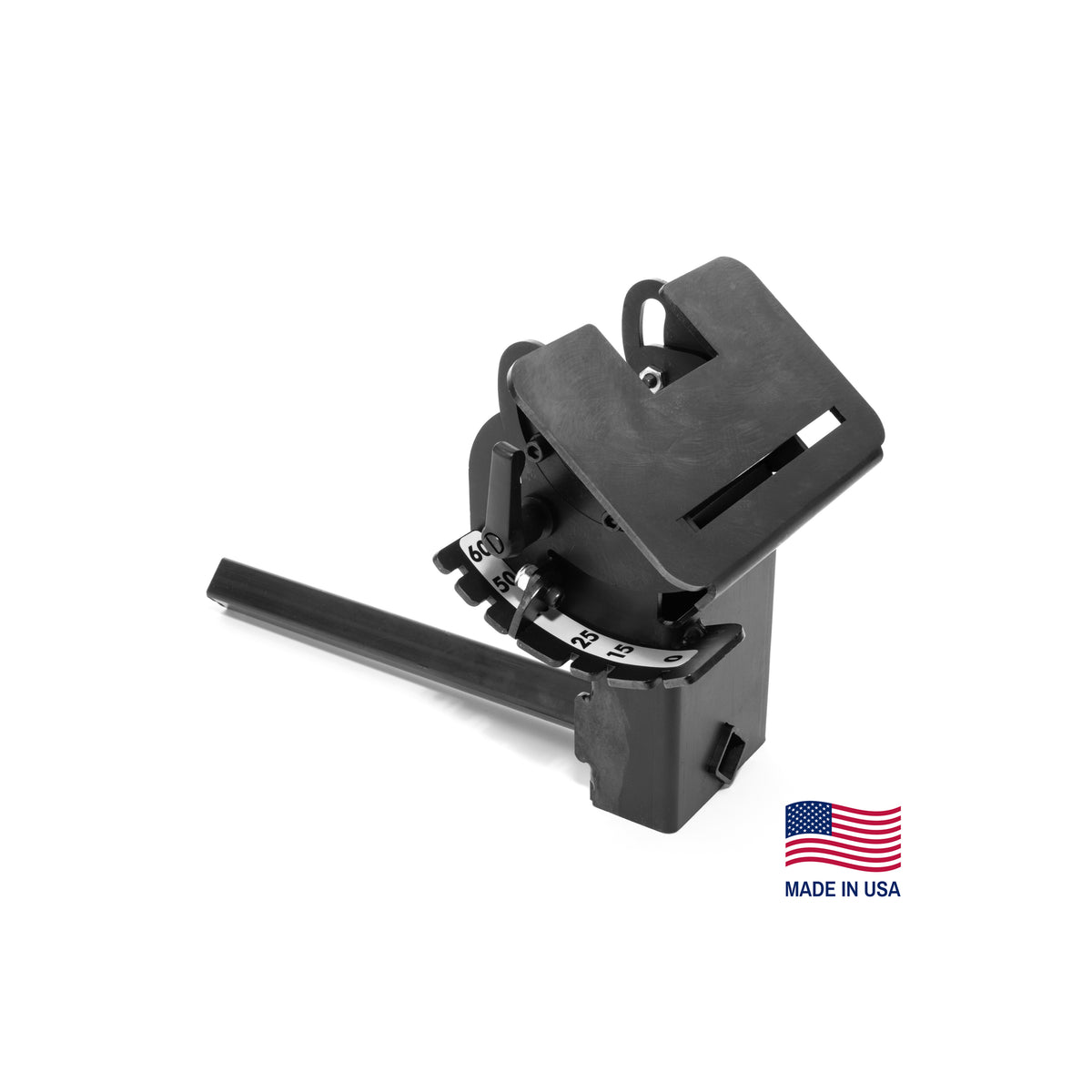

This Kodiak platform is generally overlooked but I have found it to work great. It is sturdy and repeatable.
I must express my agreement with Tom's post regarding the Kodiak platform. It attached as advertised to the Wolverine base.
Yes I love the Kodiak tool rest. I modified mine to have detents every 5 degrees that are not already indexed. I drilled holes and use a 1/8" allen wrench to go in the holes.
