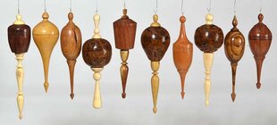

Be aware that John L is one of the world's most creative ornament makers! Look at his unique little cube ornaments - cuts 6 little "bowls' in a cube so they intersect, then embellishes. They are all different. I've got these in a place of honor in my shop (one I hung on a whisk wire stuck in a piece of burl.
A pyramid of his cubes.
And on the subject of ornaments, check out the little threaded boxes I think he calls "gift ornaments".
You can hide a little surprise gift inside, piece of candy, diamond ring!
I am blessed to have one of these as well.
(A tip: book John L for a demo at your club - you won't be sorry! Ornaments, or almost anything.
He's one of our favorite demonstrators when we manage to drag him to Knoxville.)
