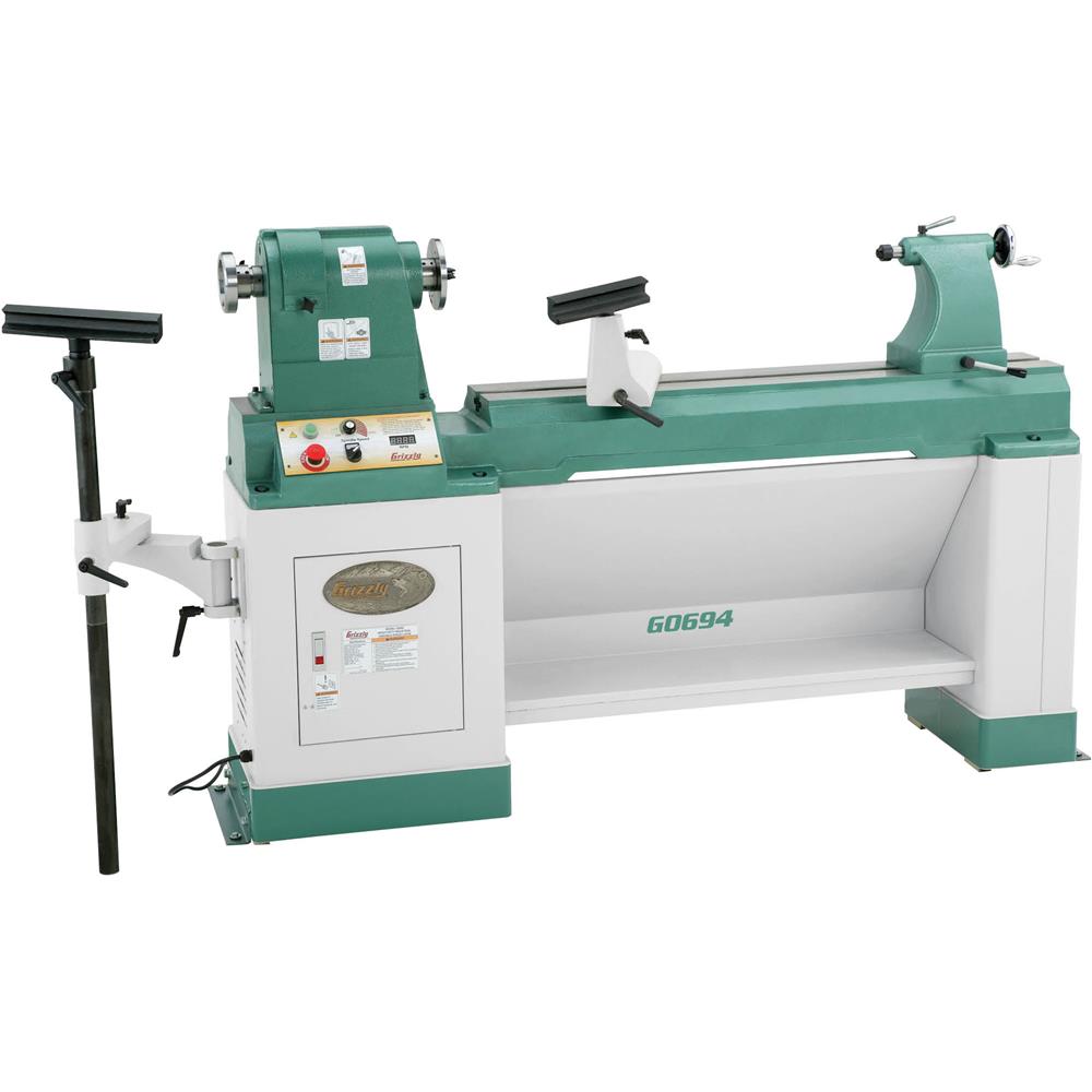

Anyone seriously contemplating the Vicmarc outrigger, price out the one on this grizzly lathe. Its similar in concept and may be cheaper
It's only available as individual parts, the price of which adds up to around $500. Anybody seen one?
