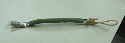

Here is a sequence of photos that show me parting a bowl from the waste block, using an old drum brake adjuster (remember those? :)) to break the bowl away from the waste block, and then mounting to jumbo jaws to turn the foot.
(edit note: These photos are from 2015, and I make the parting channel wider now. This, after a couple severe catches of the Cook parting tool catching the side of the parted channel. By making it a little wider, you can come in at an angle and keep distance between the top edge of the parting tool, and the side walls of the parted channel. The part is done in increments, from one side to the other.)
