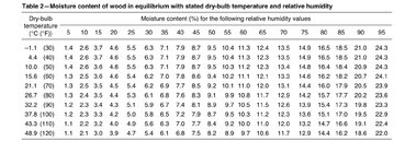

here is a chart that lists the equilibrium moisture content wood will have when left in and environment with a given temperature and humidity. My drying room has an RH of 50% and a temperature of 75. My wood will dry to 9% MC.
