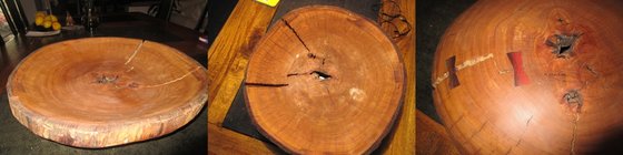

I have a large slice of eucalyptus with the pith , natural edge, oiled etc with a couple of pewas to hold it together looks like I will need another. This sort of primitive fruit bowl is quite popular down under, irregular, hand carved and oiled. Its about 20" in dia by 4" or 50cm x 10cm

Something that I always say at my demos is that I never use a Pewa to hold the piece together. The blank has to be structurally sound. I don't think I would have turned that Eucalyptus blank with that crack, especially since they are so good as firewood, LOL
lol normally for me as well , but the DIL loves it, the secondary cut has opened up more. The other aspect is its very hard as its been down for a few years and very dry
