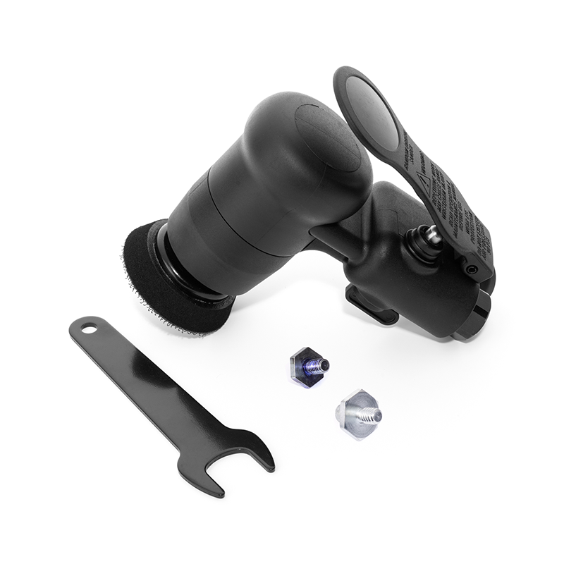

Several years ago I bought a pneumatic RO from WoodTurners Wonders that I like a lot, light and comfortable. A year or two ago I had problems with it and had to clean it out a couple times. During this time I purchased a Grex pistol grip RO. I like the WW one much better, but now use both with twist off pads for various grits and sizes; the WW is probably used ~80% of the time.
Neat. I went and looked and found this:
Is this the one you use? The look interesting for sure! Thank you.
I was not thinking a random orbital sander would work on a bowl effectively as one come up against to beads and base forms. What is your experience with the use case for coming up close to the edge of forms with a random orbital sander?
@Michael McNally - yes, that’s the WW I use and like.
You are correct that you can’t get close to crisp changes in a curve with an RO, a drill mandrel does better but still won’t keep crisp transitions. Fortunately the simple curves and designs that I like don’t have those transitions often. When they do I try to cut very cleanly and sand minimally.

I use the WW random orbital as well, but not the one pictured. I use the smaller palm variety. Last time I checked they were out of stock, but now that he is back at the helm of WW they may be available again. Give Ken a call and he will give you straight up info.
