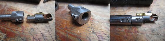

I do a lot of deep hollowing and recently decided to try the ProForme shielded cutter from WoodCut. I used it for the first time a few days ago. I was very pleased with how I could control it and the amount of material I could remove with it but I noticed I couldn't adjust the cutter shield as I expected. After examining it a bit it appears to me that the nose of the shield is distorted down and slightly twisted in a way that prevents it from extending out over the cutter edge. I would expect the shield to be able to extend out over the cutter to allow for how aggressive a cut to make and to allow the chips to clear through the gap - one of it's main features I believe. The nose of the shield on mine hits the cutter just below the edge which prevents me from being able to change the depth of cut as I would expect. Am I missing something in the setup? I've attached a few pictures that should show the issue better. I've looked online at pictures and from what I can tell the shield should be parallel with the cutter edge but slightly above it. I have a Roly Munro cutter that I use all the time and that's the way it operates.

I had similar issues with my ProForme cutter as supplied. Fortunately the brass guard is easily re-shaped with a file. You may need to adjust the height or angle of the seat as well as the nose.
Thanks Kevin. Always good to hear I'm not the only one with an issue or doing something stupid. I've resisted taking a file to it hoping I could get some response from Woodcut to send a replacement. No luck so far so I guess that will end up being the solution.

With no reply from Woodcut I went ahead and carefully filed the nose of the brass shield to be in plane with the rest of the cutter. Used it to finish up a large walnut hollow form and it worked well on wet wood. I'm not able to reduce the cut depth as much as I'd like so may have to make a few more adjustments. More aggressive than I wanted on some of my final passes. Thanks for the tip.
You may be able to increase the range by taking a round file to the back of the adjustment slot. I found the tool to be a bit hard to control on final passes as well, but it can't be beat for hogging green end grain material if adjusted correctly. A drawback is having to frequently rake out the long curly shavings- best used on large-mouthed vessels like your vases. I'll be interested to see how you like it as time goes by.
Thanks Kevin, I was just looking to see how I could increase the distance I could move the shield forward. Only need a grunt or so. This was a large, 18" X 18" round walnut I turned from the side. I'm OK stopping every few minutes to pull out mountains of thick curls - sense of progress. It did great on side grain and even the pith end grain running across the middle from side to side. Most of my pieces are end grain so next up I'll see. I don't have an angle mount for it yet so have to use it straight in. Need to get that in the works. I use them on my Roly Munro head a lot.

Just got a reply from the Woodcut folks. I had sent them pictures of my cutter and the issue. They say they are sending me a replacement and will inspect it before they send it.
Hi Randy, apologies for the delayed response, apologies for the defect we will supply you asap a replacement that as I said I will inspect before dispatch

I have a couple of them for over a decade and have no trouble with adjusting them if needs be. The height of the shield above the cutting edge is not critical, well within reason. I have reduced the height of the brass shield a couple of mm to give it access to a smaller dia centre hole.

Interesting ,on my original Pro-forme I increased the height above the cutter [ probably to around 1mm ] as I had an immense amount of sticky wet wood and found this helped some, these days my stash is dry, it functions fine on the dry.

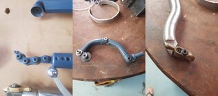

Yeah I have a slightly bent one, you will find it handy, although on my bent one I think I over did it. But I make all my own shafts and handles and bent it myself.
On green very wet wood I have opened mine up 1.5mm and its eats green wood like a hungry shark. Although it can self feed at high speedwith the wide open setting, easily controlled, but the first time can be exciting :)

The way I have found to get continuous depth of cut adjustment is to rotate the tool until the shield can be rubbed against the inside of the hollow form then rotate back to get the desired cut depth. I have made a custom mount for the proform using a 3/4" round and mount that in my original arm brace handle.
I've always believed that the real measure of a company to do business with is how they respond when things go sideways. Which sometimes they just do no matter how good the product is. Things happen. I have to say that Dan Hewitt at Woodcut has really stepped up and gone the extra mile to take care of me. Not only did he agree to replace the shield on my cutter with one that he inspected before sending, he agreed to send an entire replacement cutter assembly when I broke the one I have. Something I told him I really didn't expect him to do.
