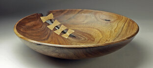

From what I see, pewa, or bowties, are usually placed perpendicular to the crack with the narrow waist over the crack. I placed a couple parallel to the crack and I think it looks pretty good also. I was just experimenting. What are your thoughts on pewa placement? Is it artist choice?
Traditionally, corners are sharp but I also like the softness of the rounded corners.

Pewa or butterflys have long been used to bind cracks together. The reason for the shape is that the "wings" lock across the crack and resist its widening.
Maybe you're repairing an old piece. Or a new piece had cracks in the wood. Or you want to make something that looks like it was repaired. Or maybe you're using pewa as some sort of artistic element. All that's fine with me.
But seems to me that if you are bridging a crack, you ought to respect the geometry and structural reason for the butterfly shape.

I’m not a structural engineer but the crack had no gap, the piece wasn’t in danger of falling apart, and I felt artistically that the way I arranged them looked better than the conventional placement. But I posted the thread to hear different opinions, so thank you!
Its your choice If you like them positioned the way you have them. But… @Dave Landers is correct, pewas are for improving structural integrity and are shaped accordingly. For purely decoration, any shape can be inserted any way you want.
Once wood has split due to internal stresses means that the stresses have been relieved so unless you tried to pull the crack closed and then hold it closed by installing patches the patches don't have any appreciable forces acting on them. Another way to look at your question would be to observe if the crack is essentially stable without a patch ... If so, the forces acting on the patch would be the minimal.
Concerning the pewa patch not going all the way through, assuming that the patch is glued in place, a lap joint is stronger than a mitered joint.
I am assuming that our normal use of a patch is an embellishment and not something that is intended to make the vessel watertight.
Back a few years I posted about pewas asking if they go all the way through the bowl wall. And observed a 3/16" thick pewa doesn't have much holding strength once it's sanded down to match the curvature of the bowl. I did assume cracks were pulled together and held together by the pewa. The above was Bill's response.
Are any folks actually using pewas to hold a crack together after it's been forced closed?

I have used dovetail keys as well as straight glued splines once or twice to stabilize cracks in turnings. If I were using a key to hold together a crack under stress I would want the mechanical advantage of a square-edged key as well as the glued surface. I hate the look of round-ended pewas but I don't think the v-inlay process is as strong as a standard routed recess with the corners trued up with a chisel. No offense, but that asymmetrical key doesn't appeal to me.
I think explicit crack repairs are ok to hold together an otherwise good form. They should be oriented with the length of the key perpendicular to the crack for strength. Strictly decorative pewas are not for me. I throw up in my mouth a little when they are made with open gluelines.
Sloppy glue lines are of course not appealing. I personally prefer the rounded corners which to me look softer, if that makes sense. I usually use pewa—and splints and round coins—just to highlight a crack which then gets filled with colored epoxy. As usual, this thread shows a variance of opinions, which is appreciated.
