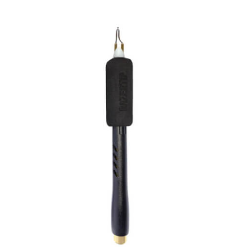

What is a quality wood burning pen for signing bottom of bowls?
There are many to choose from, so asking for advice from those with experience.
Thanks!
These are from Colwood. Either this one #1 ball tip, or this one Micro fine writing tip. I have used both of these to sign my work.
Most commercial woodburning makers have these shapes/styles/tips in their line.
Note, there is a learning curve to using them. Despite the name 'pen', they do not act like a pen in the way we use writing instruments. Rather, think about how it would be if you were using a fine point paint brush to write with; that is the hand motion and movement you apply to successfully use these tips.
I use a small ball tip from razortip
Have you ever tried writing with a wood burner? I find it incredibly difficult. The wood grain likes to slightly deflect the pen and depth of the burn varies between the hard and soft grain in ring porous wood. I have yet to see a hand written signature that doesn’t look like a summer camp project. It’s controversial but I prefer a laser. https://www.sculpfun.com/products/s...0-40cm-honeycomb-panel?variant=44648359690418
It takes practice, not unlike woodturning and sharpening. But it can be done and is legible.
Alternatively, you might consider a vibratory engraver with a sharp tip. I bought one from Harbor Freight years ago for around $10. Works like a charm. Like Donna mentioned with the wordburning tip, the engraver takes a little bit of practice to write well. Once you get the hand of it, you can write pretty small and clear. For example, if you look at the bottom of my Fox Box I posted recently, I was able to fit my first and last name, type of wood, year, and title of piece into a space a bit smaller than a dime.
