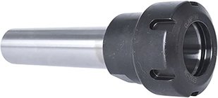

I have to much real estate out in front of me to make it easy to sharpen with the handles on. My first good gouges I bought I made my own handles and am contemplating removing them somehow and putting them in a handle with the set screws or knobs or if I ever figure out the names of what all I need to put a collet on the end of a homemade handle I'd go that route. I'm just too tight to pay what robust wants for their collet system.
Try stopping by a plumbing or hardware store, ask to look at their compression fittings (take a gouge or two, or some bar stock close to the size of your gouge bars along with you) They'd make a "poor man's" collet system if you can get fittings of a suitable size to match your bar stock.. (of course you'll need to keep a wrench nearby grinder to loosen and re-tighten the compression nuts)
I like the looks of this thing, I'm just not sure if it would work. I know it needs the specific size collet installed but I would like to find one similar to the robust with the longer nose and not needing a wrench.
The silver one is $39 and the black one is $26.

@Sam Fleisher At least with the robust system, the shaft of the turning tool can protrude in the collet if you hollow out some of the handle's diameter. This style of collet chuck does not allow this option. That being said it may limit its use.
Regardless, I don't like collet chucks for woodturning handles, Period. There are more effective, productive methods, and economical ways to make detachable handles. For further info, you may wish to read this thread:
