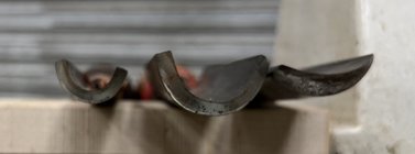

Below are 2 SRGS AND A continental. Your 1” does not have that deep flute.

I would also call that 1" a continental gouge and your 2" a standard SRG. The 1" continental is going to be far more forgiving than a SRG for what you have in mind.
