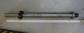

To your issue with a Laguna 1836, it should be possible to get some machining done to the spindle of your proposed lathe. I have the Revo 2436 lathe and as far as I know the spindle end is the same for both units, 1836 and 2436 that is.
My 2436 spindle below, which is around 500mm long.
There is enough meat to allow one to cut a V groove to enable one to use Vicmarc's Safety Collar.
The next picture shows a reasonably heavy/large piece of wood being held with a VM120 chuck with Vicmarc's largest face plate ring, where you can see the groove on the chuck and directly behind it on the spindle, you can see that there is enough room to cut a mirror image groove to the one on the chuck.
