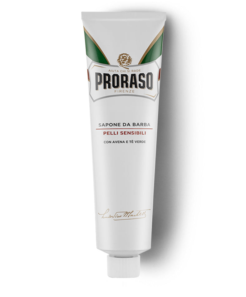

I've never used a shaving soap bar or puck that I'd leave in the wood bowl, just for the reason Richard mentions. I prefer the soap in its own container, such as lidded plastic or squeeze tube. I dampen my brush lightly to get some soap onto the brush, get a splash or 2 of warm water into the bowl, and whip up a bowl of fluffy lather. Rinse the bowl when done, dry it with a towel.
Some of my preferred soaps-
Mama Bear Awakenings
Poraso, white or red squeeze tube. White feels good, but red tube smells better to me.

Another vote for Proraso soap--i use the green, but may have to try a tube of red...this is not the first comment i've read on the scent of the red. I need to get better on the spirit expressed by @Bill Blasic, i've glued my ceramic mug together a few times in the past 50 years!! might be time to replace it. and i have a few nice chunks of Texas Ebony and Brazilian Rosewood that would be good candidates.
I like the Proraso soap but Cella Crema Sapone is still my favorite. I buy it in a 1kg brick and cut off a chunk and press it in my bowl and put the rest in the freezer for long term keeping. Love the smell of sandlewood in Taylor’s but it’s not as slick a soap as the Cella which smells like almonds. I prefer tallow based soaps instead of glycerine based. I don’t rinse the bowl since it just wastes soap.
