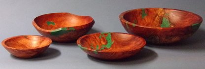

The 4 bowls above were turned from a mesquite burl from west TX and as you can see they had voids as well as borer tunnels. The burl was supplied by a resident of TX with a summer cabin in my area and the bowls were payment for a ride in his Stearman biplane.
The technique used to fill the voids was to first fill the voids with epoxy putty then turn that smooth, undercut about 1/16th", then apply powered turquoise and solidify with thin CA. The undercut technique and use of soft minerals was borrowed from Stephen Hatcher Who I saw at the 2011 symposium and I keep the handout book for reference. The use of the Epoxy putty was my idea to require less mineral and get a fill that didn't require dams like regular epoxy.
