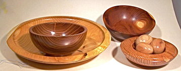

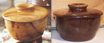

I'll show you a couple pictures of Osage Orange that I turned in 2001 and 2002, as I still have two of these here, I just now made new pictures and place them with the older pictures as to show they look now, even te bottom part that basically never sees the light is darker, albeit less than the parts that do get daylight on them, as the pictures shows.
Osage bowl.jpg 2001 turned and even the bottom is darker.jpgOsage color change.jpgOsage color after 20+ years.jpg

Gerald, very nice bowl! What finish did you use and how long ago?

Leo, thank you for pictures. Those are beautiful bowls and since my wife doesn’t really care for the yellow I guess we will just enjoy the slow transition. I’ll ask you the same question though, what is your finish on these bowls?

Richard I always use pure Polymerized Tung Oil as my finish.
