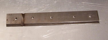

You could get some dulled planer blades and silver solder onto a steel bar, or screw it on, it can be drilled or rather burned through with carbide drillbits.
I have used pieces screwed onto hollowing tools.
