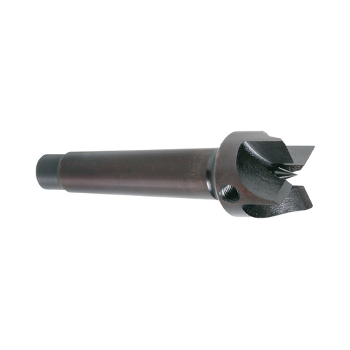

A set screw sits in a notch on the center pin in front of the spring?
My set screw backed off earlier today and the spring decided to launch the pin into the land of the lost. So I need to acquire another just to have a spare if nothing else on the off chance I find it while sweeping.
The one I'm using wasn't very much and it worked but if there's a brand out there built differently I'll give it a try.

They are all similar. The ones with short spurs are worthless.
I want long spurs and a removable point. I don’t like a spring loaded point. I like the positive hold of the fixed point set about 3/16 proud of the spurs
The 1” detla spur drive has served me well.
Packard used to carry them may still have them but didn’t see it on his web site.
These folks have them
Not sure the center pins from other mfrs will fit, and I don’t remember seeing replacement pins for sale - may have to call the supplier/mfr. If you end up needing a new drive, This brand has has worked well. Other sizes and stebcenters available. I prefer the spring loaded pin - it doesn’t create a large divot. The spurs hold the wood.

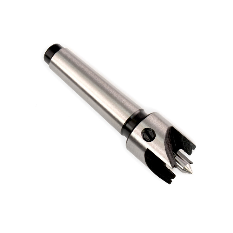

I did find this one from axminster which is made a little different in that the adjustment of the spring and the set screws are at the back of the drive. (see the video from that page)
Since I'm using axminster chucks and jaws and like the stainless steel guess I'll give this one a go.
Old thread I know but I've since found out and bought one of the sorby steb centers which has the set screws in the end instead of the side similar to the axminster.

I have seen those and I do have one that is just a spur drive. The "crown" ones I've seen have the set screws on the side. Not a deal breaker probably I'm just gun shy. Or maybe I just need to keep my floor cleaner.
There are a couple of ways of making these things. If the set screw is perceived as a problem then it could be fixed in place with thread lock or maybe even super glue? Gentle heat should allow it to be removed at a later date if required.
