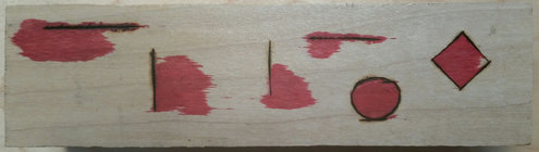

If it's migrating around the sides to the back, I have heard (as in, I haven't tried this) that a burned line will stop dye migration. Something like a wire, or piece of formica to burn a fine line around the edge. Formica can be sanded to a knife edge for super fine lines.
If I'm out in left field... Disregard...
Well, I had my burner out so... Burning a line seems to help somewhat sometimes... so a little more experimenting maybe. I put a drip (eye dropper) next to the line, maybe too much, but you can see the results. The two lines on the left were a little hotter and a little deeper. The lines with the grain surprised me, I would have thought just the opposite of what 's shown. Burning a line around the circumference of your tops with a wire might help, but would also change the design.
Ps. Chroma Craft dye, not sure it matters, just what I had...
Thanks for that Clifton. I suspect the best solution will be return the piece and recut the bottom edge. I have a small vacuum chuck I got from Rubber Chucky. I'll try that.
