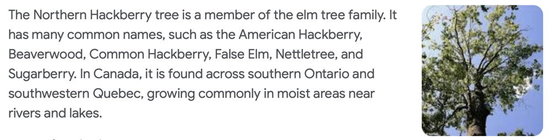

There are a few apps that are great at identification with leaves. I use one call PictureThis. It keeps asking to subscribe but can use it for free if you don't need a library of what you've done or other gardening info, etc. There's also one call PlantNet. I use them all the time when I need to know a tree, bush, weed, grass, vine, etc. Does them all.
I downloaded one of your pics of the leaves and Michael is right, the app says it's common hackberry (american hackberry, nettle tree, beaverwood, false elm, and other names)

Yes Reed, they often or even usually have the ridged bark, however there are several Celtis species, and some have smooth bark, also so-called Sugar Berry has apparently often smooth areas.
I was not familiar with Hackberry, when a friend asked me about some trees he had on some property he had bought, as I saw the ridged bark it was easy to ID it, my brother (RIP) had one tree on the bottom of his property that I ID for him, and showed him the leaves that are so much like Elm leaves, a close relative of the Hackberry trees.
