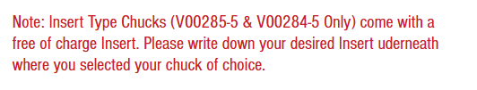

I have a powermatic 4224b which has a a 1 1/4-8 thread. I am not sure about if I need an insert or not for my lathe. This is from the Vicmarc Website which is confusing to me... since I can pick up the thread from the chuck..1768962225956.png
Some chucks are direct threaded. So the threads for your spindle are cut directly into the chuck body. Such as "1 1/4" x 8 Standard Jaws - V00285-3" . All you need is that.
Another style uses an insert. The chuck body is threaded, but not to fit any lathe spindle. You get a separate insert that is threaded for the lathe. Useful if you think you might change lathes or might want to move from one lathe to another. Inserts are also available for less-common spindles (left-hand thread, etc). If you were to purchase the "M45 x 2 Standard Jaws (Insert type) - V00285-5" then you'd also need an insert to adapt to your 1-1/4x8 spindle. So you have to tell them which insert to include with the chuck. https://www.vicmarc.com/product-page/chuck-inserts-vm120-150
