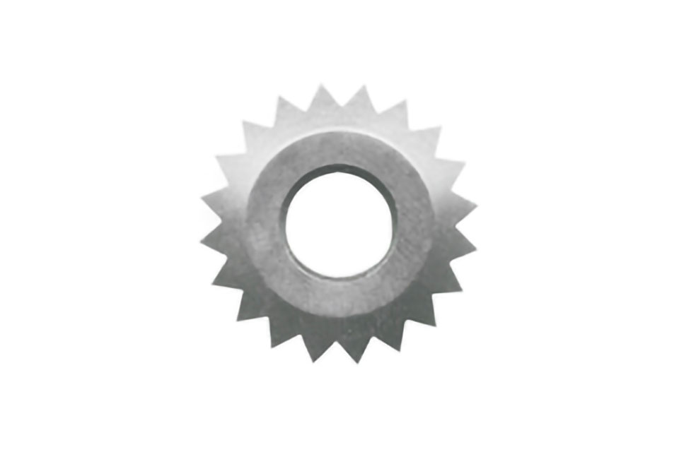

For these, I use a star-shaped wheel with very sharp points around the circumference. I have a wheel like this for my large Sorby and one for a small, shop made, texturing tool. The wheel on the large Sorby set has a larger diameter but the space between each point is larger than the spacing on the small texturing wheel I use. The larger spacing doesn't work as well, to my satisfaction, on smaller diameter spindles as the wheel with the smaller spacing. I'm not at the shop now but I think the diameter of the first handle shown (on an "oven stick") is well under an inch, probably closer to 3/4". The small texturing wheel works well on this diameter, making the closely spaced dots.
I think for the Micro set I must have purchased a separate texturing wheel with sharp points. Maybe it's this one called the "Sorby Micro Texture CUTTER".
I saw that cutter somewhere in a picture taken at an angle and it appeared to have very sharp points around the circumference. If you don't have one with sharp points, you might call and ask if the one Packard sells does. If not, I've also seen them offered at an industrial supplier, Granger maybe. You just have to be sure the shaft of the tool matches the hole in the cutter.
Or maybe Crafts Supplies sells the sharp pointed cutter since they offer the Micro spiraling set:

Also, if I didn't have one with sharp points, I might try to modify one with a CBN wheel on bench grinder. (That might be "fun"!)
So do you have the spiraling wheels with the sharp flats or a wheel with sharp points? Maybe take a closeup picture of the wheels you use, from an angle that shows the points.

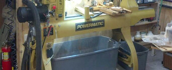

I had that screw suddenly get loose and it spun itself out and buried itself deep in a pile of shavings
Brian (sorry, I don't know how to do the @name thing in a post), as for losing things in the saving pile, I've done that as have many, but use two things that help. #1, I collect most shavings the dust collector misses, with big plastic tubs under my lathes. This usually catches anything that falls.
#2, when full enough, I take the tub outside, sift through with my fingers, then dump the shavings on the ground in the woods behind my shop. I spread out the shavings and use a metal detector to find anything I missed. (the non-discriminating wand detectors made for boards and logs at the sawmill work well)
This wouldn't be as easy if I lived where I had to bag the shavings!

Is that with a small diameter point wheel or a larger one? I have various sizes of the pointed star wheels and my favorite are the small wheels, maybe 1" in diameter. The big Sorby texturing wheels, like the one in the handle at the top of this photo, are too big for my tastes and leave bigger gaps between the lines due to the wider spacing on the points. The red-handled Sorby Micro texturing tool in the middle is perfect, as are the two shop made texturing tools at the bottom.
Sometimes the Sorby Micro tool is advertised and sold with just the spiraling wheels (Amazon sells it), not as useful, but when I wanted another one I called first (I think I bought it from Hartville Hardware in Atlanta) to make sure the pointed wheel was included. You can buy just the pointed texturing wheel separately if needed from various places.
From their write-up, it looks like CraftSupplies offers the tool with both the spiraling AND the pointed texturing wheel. But I'd call to make sure!

I have the smaller one, the red Sorby you picture there. I think it came with three wheels? I've used it before on spinning tops, but not to great effect. I have thought many times about getting the bigger sorby one, but never have. I ordered the Wagner knurling tool from CSUSA.
I haven't made your wicked point tool yet. I was using my EWT detail tool, and its a lot harder to control. It makes a very fine groove, and if you want to widen it...well, its hard. Hence the less than ideally shaped grooves at either end.
