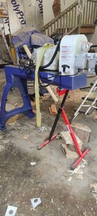

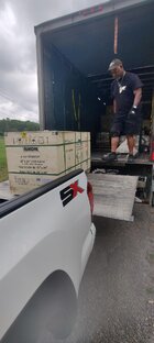

The truck driver couldn't get up my driveway (he was in a semi) so I drove down to the road and we loaded it into the pickup. That worked out pretty well because I didn't have to lift the lathe. I was able to slide it out enough to attach the right side legs. It got a little dicey on the left side, but I prevailed.
Half way there.

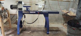

I think I'm ready to give it a try. I bought the bed extension primarily so I can slide the tailstock out of the way. Rikon accessories are pretty reasonable. I bought a bundle which includes an outboard tool rest assembly and the 16" bed extension for $250.

Looks like a well thought out lathe to me. It has some very important features that would be mandatory for me, if I ever replace my 32 year old Woodfast lathe. (IMHO, the first two of these three features represent the future of woodturning)
Rotating headstock
Magnetic relocatable control box
Offset "elbow" or "dogleg" style banjo
Also, there are some other very interesting and innovative features, such as the 3-position relocatable extension, and choice of running the motor on either 110v or 220v.....among others.
The only thing that would be a deal killer for me, is the weight is only 373 lbs. I would only be interested in another lathe that is as heavy, or heavier than my Woodfast at 525 lbs.

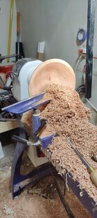

No updates. The lathe runs great. I have adjusted to the on/off switch operation. I haven't encountered any new cons. I highly recommend it.
