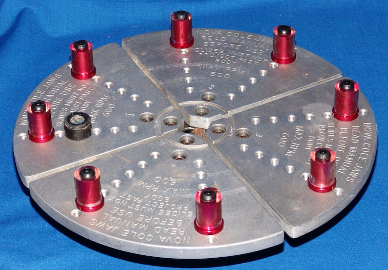

I can't remember just who suggested these Cole jaw extended grippers, but after having trouble with mounting a bowl on Saturday, I realized they are just the thing for a few of my permanent bowl shapes. Whoever it was that brought these grippers to my attention......thank you! :D
https://www.etsy.com/listing/204150998/special-tall-grippers-for-oneway?ref=yr_purchases

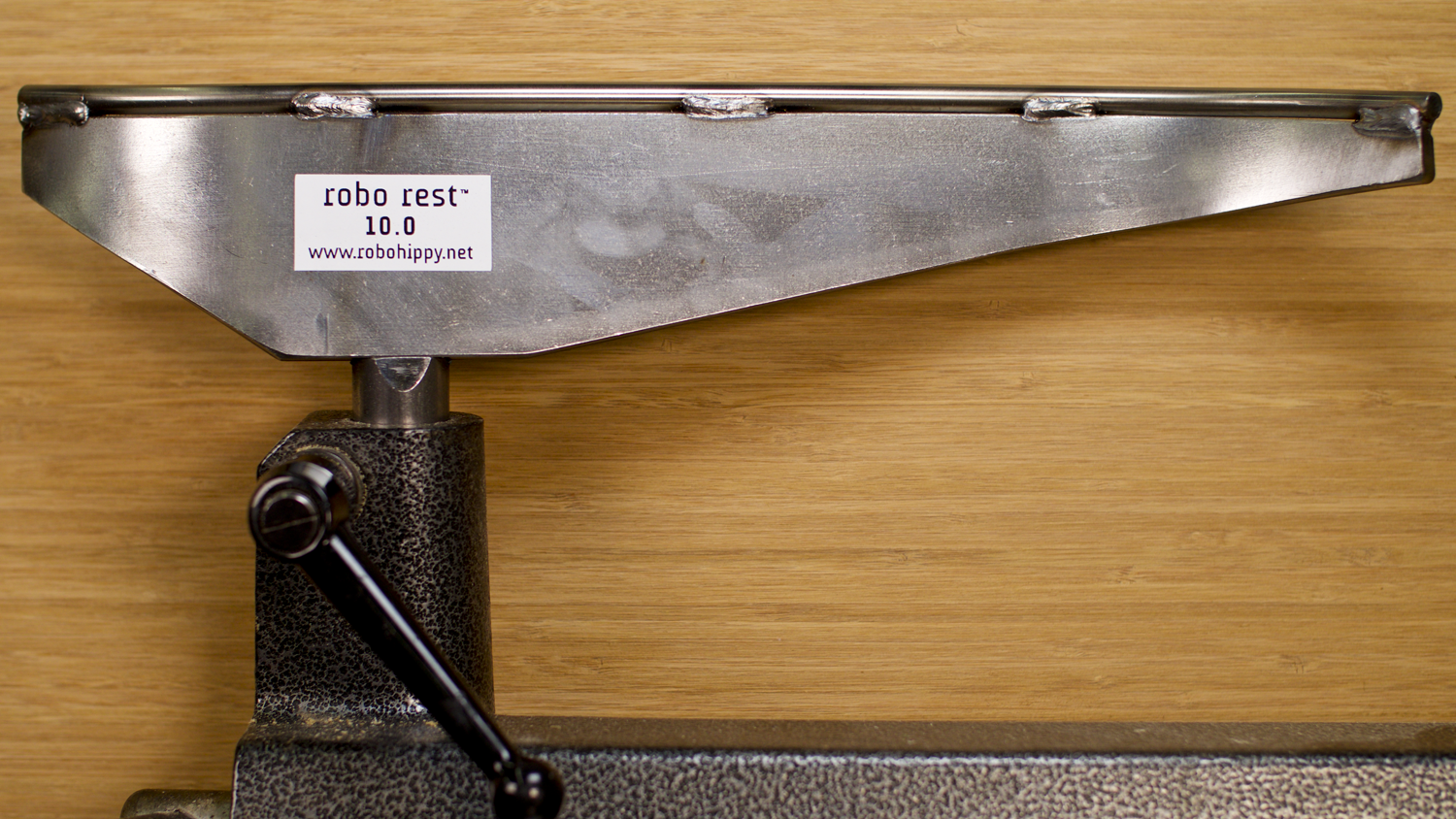

That's far from being the only thing I've purchased, as a result of participation on this forum. Just a couple weeks ago, I purchased two Robo-rests, which I'm very happy with. I consider them better made than another well known tool rest of this type. If you want one of these Robo-rests, you better get it now, because Reed has decided to quit this business, to concentrate on his lathe turning. :(
https://www.robohippy.net/store

Got those grippers a while ago, went to use them for the first time last week, got them all installed on my Cole jaws and then found they wouldn't open wide enough, so now I own $300 of (Ron Brown) Longworth chuck and donut rings.

I've been stacking factory Stronghold grippers on the jumbo and mega-jumbo jaws..... plus a combination of washers and spacers for many years. The Stronghold grippers are slanted on the sides, and some applications are a bit difficult to do with great success. Since the stacked grippers do work, and open wide enough for me, I don't suspect I'll have any problems. The vertical sides of these new grippers will be better for some applications. :D
No, the Cole jaws, on my one and only chuck, wouldn't open wide enough to grip the exterior rim of the bowl. Bowl was about 13" is diameter.

Odie I use the Jumbo jaws a lot, I do have extensions for it and also extra sets of buttons, they can be stacked if the need arrises, able to hold quite delicate as well.
Hi Leo......:D
Yep, that's what I do, too. Also, various washers and nuts can be used as spacers, so that the point of contact can be adjusted incrementally.
Note: There is a kit available for stacking the original Oneway grippers. This includes machine screws that match the tapered metal interior surface of the grippers for better centering. ;)

Yes I do have those and several button sets as I have 3 different size Jumbo jaws, for my mini, midi and large lathe, screw galore with the half dozen Chucks and extra jaw set, though none are long enough to do stacks of buttons, so some metric bolts and nuts are used whenever needed :D Thumb-up.gif
