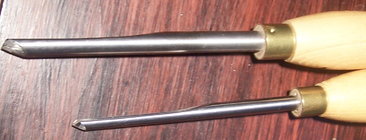

Left is Thompson 5/8 shallow, center is Thompson 1/2 deep, right is sorby 3/8 standard... the flutes are significantly different.

I think that in a true spindle gouge it is pretty difficult to make it a deep flute spindle gouge, there is a reason why spindle gouges have a shallow flute, it's needed to use it in turning the deep and narrow cuts in spindles, that is basically not going to be possible with higher sides of a bowl gouge.
Would you say the Thompson is roughly the same depth as other spindle gouges, or is it deeper fluted than 'normal'?
The Thompson detail gouge is much shallower. The deep flute Thompson is half way between a standard spindle gouge and a round bottom bowl gouge.
