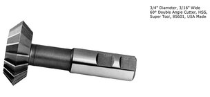

I’m not sure if this is of interest but I’ve just received a 60° HSS cutter I ordered from Aliexpress. I intend to use this for thread cutting with my Simon Hope jig. I obviously need to make a mandrel for it on my metal work lathe first. I mention it as if you can do the same or know someone that can help, these cutters are quite cheap at under £20 from Aliexpress. It’s 35mm Diameter with a 13mm Bore.

With a one piece cutter you cannot run the lathe in reverse as the teeth would face the wrong way. With this cutter though you can flip it round the other way on the mandrel if it makes things easier for the job in hand.

Edit: I should perhaps have mentioned that one of the reasons I bought the cutter was so I could use it to make some “Bolts” or Bolt Boxes. The standard cutter that came with my jig is too short to produce a long enough thread for it to be realistic. You can buy cutters with longer shanks but I thought I’d try the Aliexpress cutter.
If I was cutting box threads with that cutter, and I have several, I would grind about 3/4 of the top part off. For these nuts and bolts you show here, nice job by the way, I wouldn't mess with it. My old Bonnie Klein threading jig has a machined head the cutter is mounted in, and my Baxter jig has a morris taper jig with an all thread rod on it. I do not notice any difference in how they work. One is not really any better than the other. I do think the all thread, with a butterfly wing nut and locking washer is necessary for the morris taper set up. That beats the lock washer and standard nut where you have to dig through the shavings to find the wrench....
There are limitations of the minimum diameter female thread the cutter will do with its 1.377" diameter (35 mm). The thread profile is distorted when you get to a certain minimum diameter. When we buy threading cutters for metal working the cutter will have a minimum diameter specified.

I bought the cutter for use on external threads. My standard cutter is long enough for internal ones.

Your cutter has a key way to lock the cutter to the arbor, your arbor doesn't have a keyway. With that large cutter diameter, you may get some slippage between the two.
