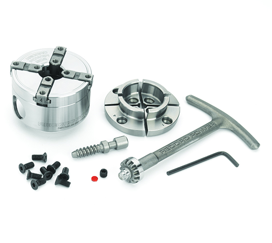

If you’re after a small chuck that’s very light I can recommend the Record Power SC2, it’s just 2 1/2” Diameter.

I used my little RP SC2 chuck on my Simon Hope threading jig. Having less weight hanging on the spindle was a definite advantage. I’m thinking of buying another specifically for jig use. One for the base of boxes the other for the lid.
That is a nice Chuck, I have one. The jaws are a little different and won’t fit the normal RP and Nova chucks or jaws. Mine came threaded for 1-1/4” by 8.
Bill, can you explain further what advantage the smaller chuck on your threading jig is providing. I have been build and testing my homemade jig. With a 3/4 (19mm) 10 tip I did not see any droop from overhang using my Axminster SK100 (gear type). Am I missing something. I have only done a couple of boxes so far and they are working fine.
My small SC2 chuck weights 505g, the Axminster SK100 weighs 1,773g. I’ve found it very much easier to set up my jig with the SC2 hanging out the front. It also must be putting less pressure on the jig. All in all I think a small chuck like the SC2 is more suited to the job. Obviously though you can use any chuck you like. One chuck I most definitely won’t be using is my Supernova 2 at 1,885g, but I may use the SC3 at 1200g. Sometimes it’s handy to keep both parts of a box mounted in a chuck to preserve concentricity so I’ll use the SC2 and SC3. All weights are chuck only without Top Jaws.
