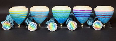

Trying to get a blue finish with blue dye, tips?
Feb 8, 2020
6
Indianapolis, Indiana
Hello, I'm using a Mixol blue dye on a yellowish wood (Dot Ebony) but the result is a blue-green. I'd almost expect this, considering the slight yellow of the starting piece, so I tried mixing in a little black, but it ends up being too dark, and more black than a deeper blue.
Is there a proven method of getting a blue result with a blue dye? I haven't completed turning, just testing, so I can still do some trial and error.
Letting one coat "dry" and applying a second "coat" doesn't darken the color.
Thank you all.

I use oil paint thinned with linseed oil and a bit of turpentine. Apply as a wash. Applied with a brush and rubbed in. Takes awhile to dry though.
You need to bleach the wood using a mixture of sodium hydroxide and hydrogen peroxide. Here is a link to a tutorial I posted on making your own wood bleach for a fraction of the cost of commercially available wood bleach. Neither chlorine bleach nor oxalic acid can remove the natural pigment in wood.

Picked up from the Air brush guy at TAW a few years ago. All woods have their own color and if you seek to achieve a specific color then the wood has to be bleached. Bill's article gives you what you need to get there with dye. With wood stains there are many ways to get the colors you want but it is a stepped process with several different products involved. Another thought is that even withinthe same species you can get different shades of the same color.

After coming up empty on the 27% peroxide, I found that the same DIY store where I bought the drain cleaner also sold the Zinnser kit. I returned the drain cleaner, picked up the Zinnser for $2 more than the drain cleaner, and I think it worked great for my need, I’m just turning a pen, so at the rate I’m going, that $9 kit is a lifetime supply. If I were doing more bleaching, I’d be getting a gallon of 27% online somewhere.
I would’ve been stuck with a green pen if it weren’t for y’all, thanks!
