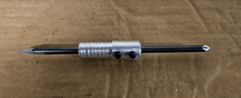

John, thanks for posting this. I made an aluminum insert to hold 1/4" shafts. Shown here with a homemade Cindy Drozda style point and vortex grinds.
Your instructions are great. As you said, it's relatively easy to do. Drilling and tapping the holes for set screws was the toughest for me. I'll add a small wooden handle tomorrow.

It's been a few years since the demo, but just a couple of days ago a friend showed me another insert he made.
I don't remember putting this pic in the document - it shows some other things turned from aluminum, etc. The little tops spin nicely. And I thought the off-axis "crazy golf tee" was going to be tricky but it wasn't. The golf tees (from wood) are something Frank Penta showed in one of his demos. I've made several for gifts for golf fanatics.
I had to come up with a different way of holding the metal since what works for wood to change the axis (crushing the fibers) ain't so good for metal!
