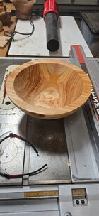

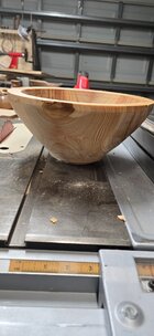

You are the man! Thank you so much. Here are a few pics of the first two that's turned thick, sealed and drying. I would always rather "once turn" but I had no idea with cypress.
What kind of walnut oil do you use?
I have some of the doctors woodshop microcrystal wax walnut oil but I'm guessing I want it to soak in and not sure if it being mixed with wax will cause it not to soak in as well. I might be overthinking it but I doubt I want to french polish it in.
I'll post more pics as soon as I have a moment to turn a bowl.

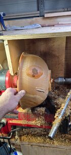

That is a very intriguing method for making once turned bowls out of green wood. Two questions come up. 1. Does this method work on any wood or are you referring to Cyprus only? 2. Do you still get the usual warpage of green wood? Thanks
On the topic of drying wood in general, here's an excerpt from an upcoming revision of the book "Cut and Dried"-
I’ve used this method on Oak, hickory, cherry, apricot and walnut. I figured that if the oak didn’t crack, other woods should be a breeze. Yes, they move just like any other once turned bowl. Not sure of the amount is the same, but assume it is.
