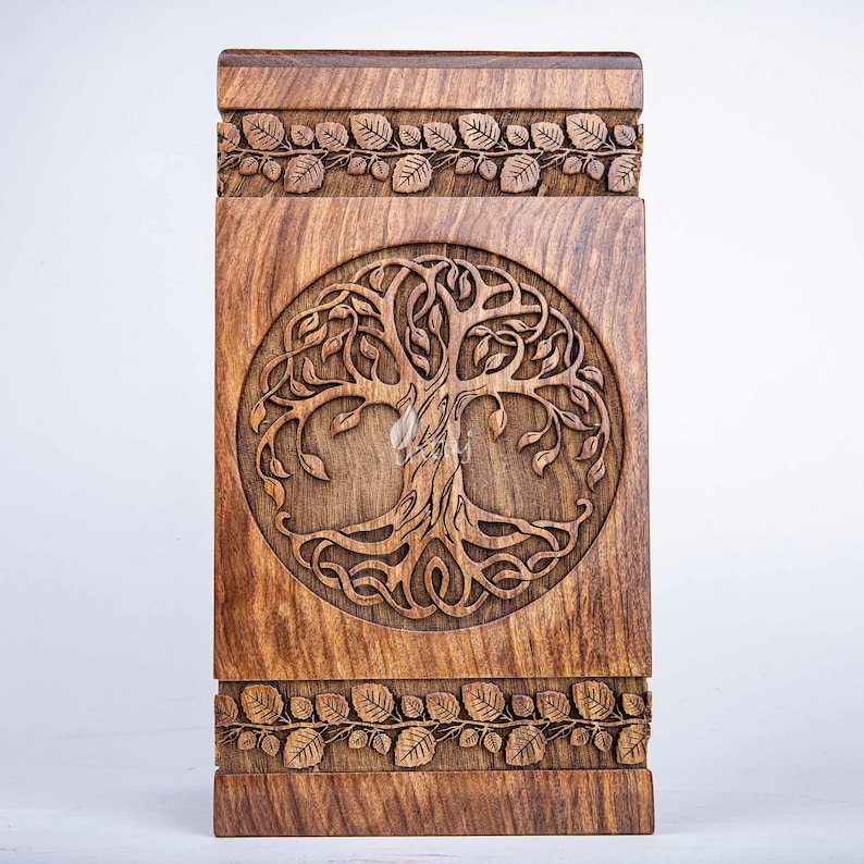

just in case anyone is thinking of getting rich making wooden urns, here is your competition from India for $42 delivered. Rosewood
