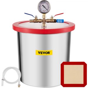

Anyone using vacuum chambers to stabilize wood? I have wondered about this for some time but, never tried it as yet. I do have an old pressure cooker pot I could try this with but, I have a customer with some larger chunks of oak she would like made into bowls. The oak is punky on the outside and my proposed vacuum chamber is too small anyway. Can a steel drum be used a vacuum chamber? Or would it likely collapse in on itself? Just looking for answers before I talk to her about options. Also, the oak is wet about 25-30% moisture. Can it be stabilized as is or does it need to dry first?

Pressure cooker pot could work, but you'll need to modify the lid to remove the pressure valves and relief valve (and automatic latch on some) I made use of an old pressure cooker pot for the same purpose , and it holds 20 inches vacuum easily - I have seen folks make use of heavy barrels to do the same thing, so I'd say most any container you can seal airtight and draw a vacuum on would work , as long as you are able to pull the target vacuum and then some (say 10% to 15% more or so) without the sidewalls or lid flexing in (which could cause your resin to squeeze up and out the vacuum port and screw up your vacuum pump) - With an in-line shutoff you can pull vacuum and then shut off (and a vacuum gauge somewhere past it to monitor vacuum levels) to reduce the chance of pulling material into your vacuum pump (and also minimize the run time)

I bought a 5 gallon BAECONG about a year ago. The prices have more than doubled since then. Works as expected. Yes, wood must be dry. With Cactus Juice you also have to bake after vacuum to cure. So, make sure you have an oven big enough, and don't use an oven you also use to cook your food.

A 5 gallon pressure pot base works great as a vacuum chamber - just make a flat lid with a rim seal and a q/r fitting for your vacuum pump hose. My vacuum top is 3 layers of scrap 3/4" ply glued together and some thin foam on the bottom for a seal, with a plexiglass view port in the center so I can see into the pot while drawing a vacuum - very important as it is easy to pull so many bubbles to the resin surface that it will bubble over the edge of your mold.
put your filled mold into the pot, draw max vacuum - wait till major bubbles stop as entrained air is removed (including inside the wood), release vacuum and top off mold if necessary - repeat a few times until no more big bubbles ~ 15 minutes total - then put on pressure top and leave pressurized over night.

You are correct - you will pull air through the plywood end grain - I sealed edges & faces of the ply top with a coat of resin - here is the top on the pressure pot - no need to secure it, as soon as you hook up the pump air pressure seals down the top -
underside - uses hobby foam from wallmart - put wood baffle over vac connection because when removed hose in-rushing air would blow resin around the pot
