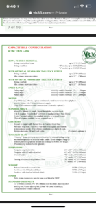

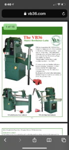

I picked it up yesterday and will need to clean it up a bit. It hasn’t been used in a few years but is in excellent condition. It’s built like a tank and is very well made. Tolerances remind me of engine pistons. The footprint is 21 x 20” but adding the tool rest and tailstock bars adds to the overall size. I can keep it tight for of my faceplate work. It will take up less space than my 3520.
