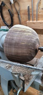

Walnut
Nice example of all of the wild colors you can see in fresh cut walnut. Purples, greens, yellows, browns, and every shade in between. Should be a stunner when done.
It is end grain with no pith. Always wanted to try an end grain bowl. Not fun hollowing the inside.
What tools/method did you use? Are you aware endgrain cut direction is opposite facegrain, ie for the ID its center to rim.
I typically dig out the center with a 1/2” spindle gouge, and when it starts to chatter switch to a long wing 5/8” bowl gouge. Once you get the hang of it it wont take any longer than facegrain.
Thanks. Going to have to dry for about a year.
That depends on how thick it is. If more then a 1/2" thick coat the primarily end grain areas with Anchor Seal and or place in a brown paper bag. Note: eliminating the pith helps to avoid checking around the pith but also introduces the problem of that the piece will go oval as it dries, which may require a thicker wall to be able to round it out on the second turning.
I started with a 5/8” bowl gouge and ended up doing pull cuts with a 1/2” bowl gouge.
I always rough turn minimum 1” and thicker on a larger bowl. It is waxed inside and out. There is no pith. This is a cut off from one of the 12” by 12” pieces I got.
