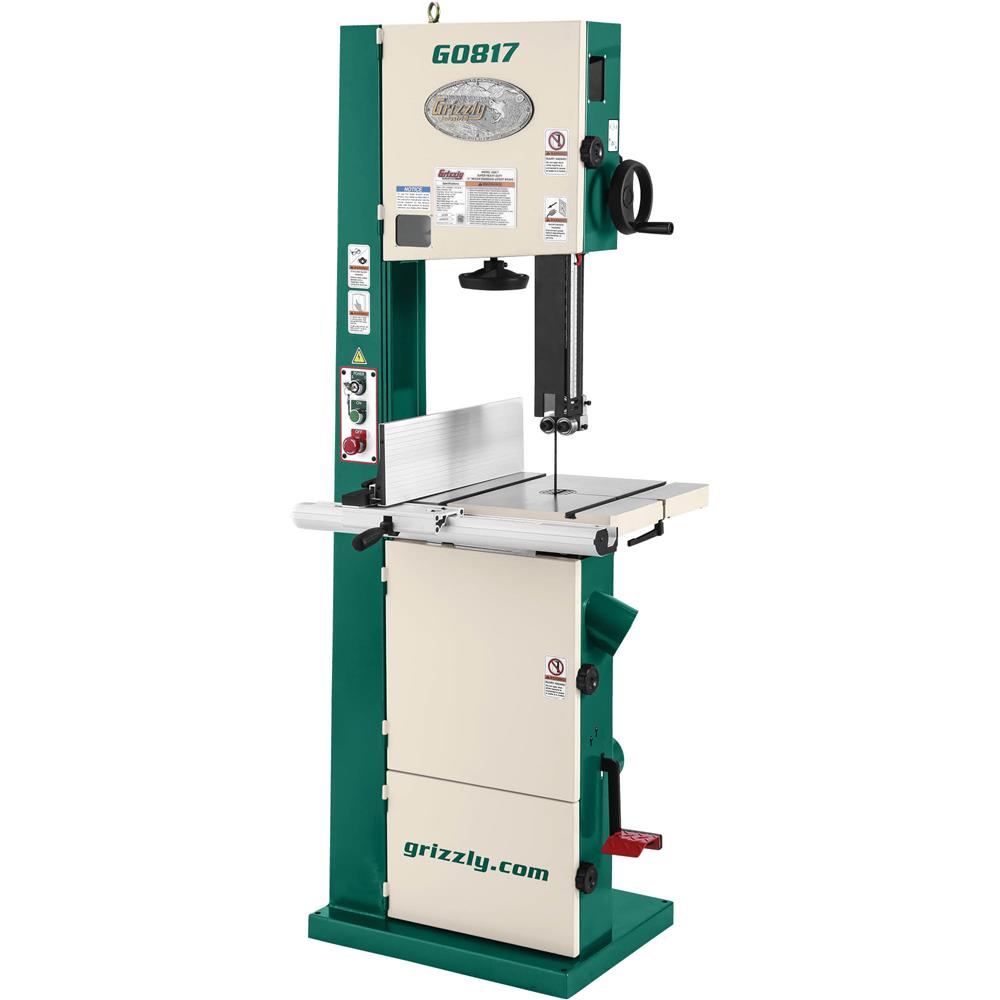

Last year, after having a Grizzly 16" Delta knock off for about 40 years, I purchased a new Grizzly GO817 Super HD 2hp Resaw Bandsaw with foot brake. I immediately converted it to 220v. It suits my needs perfectly.
Not as huge as some of the older bandsaws being discussed here, but everything I've been needing since the sale of my old Grizzly 16" bandsaw with much less height sawing capability.

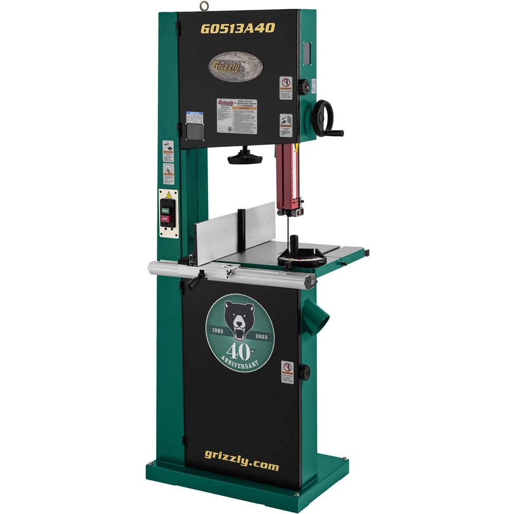

Grizzly has a "40th Anniversary" 2 HP 17" bandsaw for $1,300 + shipping. It looks like a lot of saw for the money:
I have a G0513ANV, bought new in 2014 for $850 plus $100 delivery, this looks very similar and is a lot of saw for the money. The older one had a grizzly bear decal on the side and imho looks better :)
