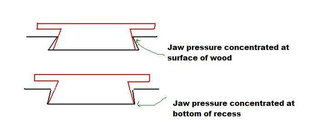

Wonderful description and some beautiful bottoms! One question—why make the recess walls straight and not dovetail since the jaws are dovetailed? Won’t there be less contact?
Thank you for the kind comment.
The danger is making the dovetail angled too much so the sides of the jaws contact the top first, at the surface of the wood, where the wood is weakest. No such problem if the recess angle ls angled less, a bit straighter than the dovetail on the jaws. But it turns out vertical sides on the recess hold just as well since the angle of the dovetail concentrates all the forces right at the bottom, compressing the wood slightly there. Since the rim of the dovetail is tight against the bottom, the wood is very strong there and there is no chance the piece will come out off the lathe (unless the turner is REALLY good at violent catches!)
Here's a little sketch. The jaws are represented by the red lines.
(In addition to the angle, remember for the most holding power the diameter of the recess should be as close as possible to the outer diameter of the closed jaws in order to have the maximum contact all the way around. Most know that as the recess diameter increases from the minimum, the jaw contact length and holding power decreases. A vertical side on the recess can help a bit since the jaws don't have to be expanded as much!)
Fascinating. I’ve never seen this recommendation or explanation. Would you recommend and say the same—straight sides—on a tenon?

If the inside of the jaws are dovetailed instead of "beaked" I might cut a "mild" dovetail on the tenon, again being careful not to make the angle too much or the same problem of crushing the wood at the end can happen.
The best holding is as with the recess with the diameter close to but a bit bigger than the closed jaws. However, if the tenon diameter is too big one advantage over the recess is the four jaws will the grab the wood with 8 sharp corners instead of with 4 too-small curves.

Ah wow nevermind you answered my question!! Thank you I'm going to give this a go!
