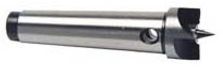

Thanks all! The lathe is brand new - I’m contacting the vendor and manufacturer to see what they can or will do. Here's a picture of the machining marks.

Sarah, I did answer your question, but discovered the post did't make it, so I'll try this second time.
I would not accept what you got as a finish in your lathe spindle, period.
Morse Tapers, both male and female are to be very smooth, they are normally ground to a mirror like surface, not just turned as what appears to be done in yours.

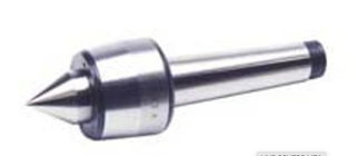

Here are a couple pictures of my lathe spindle, you can see the inside some and the ground mating surface for a chuck to but up against, (sorry for the wood dust)
Also the MT surfaces on the male parts of the live centres and the driver.
I would not accept less and return these pieces, it is just shoddy machining, trying to cut cost by cutting corners in the machining.
